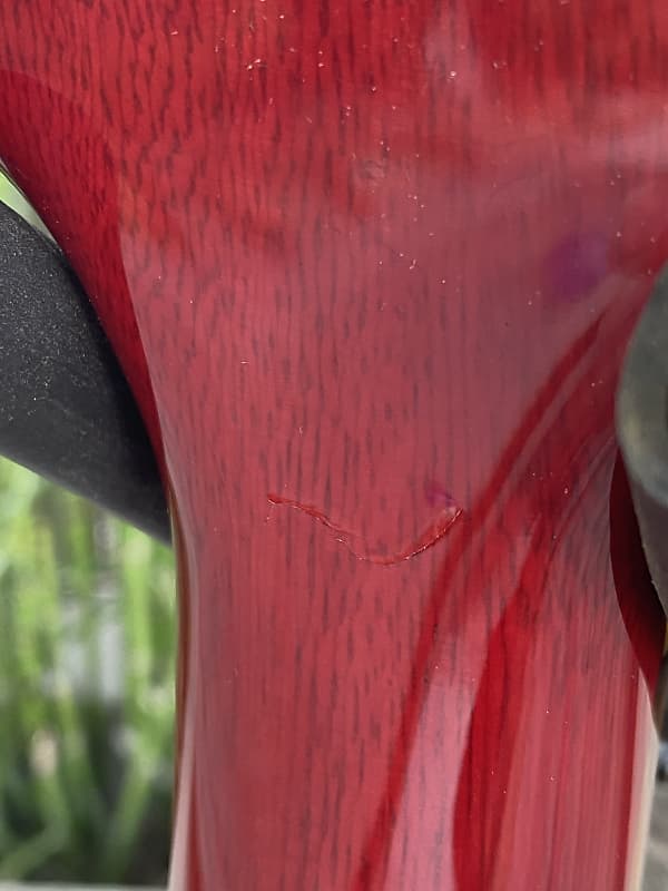

HamerCustomEr Posted June 22, 2024 Posted June 22, 2024 On 6/20/2024 at 9:02 PM, stratacus said: I did a quick search and found that Mahar's Vintage Guitars and Lovies Guitars had previously sold this same guitar with a "finish crack" on the back of the headstock in the same location as the nick / scratch mentioned above. From Mahar's Vintage Guitars website: ...one finish crack on the back of the neck where the headstock transitions into the neck. This is not a crack, just a finish line that looks like checking, but it is likely from a slight stress to the neck at some point. Included below are links to Mahar's and Lovies' Reverb listings for this guitar, with their photos of the damage and COA's for serial # 5 54016 Mahar's Lovies Great work, detective!
stratacus Posted April 29, 2025 Posted April 29, 2025 Here’s a plot twist. I called Music Zoo and let them know about the likely crack underneath the white stinger. Music Zoo got back to me and offered to sell it at a lower price… How it started: I dropped the guitar off at reputable guitar shop in the Chicago ‘burbs while in town for the Hamer 50th even last October. FedEx just delivered it to me this afternoon:
Tortious Posted April 30, 2025 Author Posted April 30, 2025 Sweet! So what was the verdict with the original cracking? Just finish? Whoever did the work looks to have done an impressive job.
stratacus Posted May 1, 2025 Posted May 1, 2025 On 4/30/2025 at 5:31 PM, Tortious said: Sweet! So what was the verdict with the original cracking? Just finish? Whoever did the work looks to have done an impressive job. There was a slight crack in the korina beneath the truss rod routing where it was thin due to the depth of the routing. The korina in the area of the crack was replaced: This was followed by some mad sorcery.
