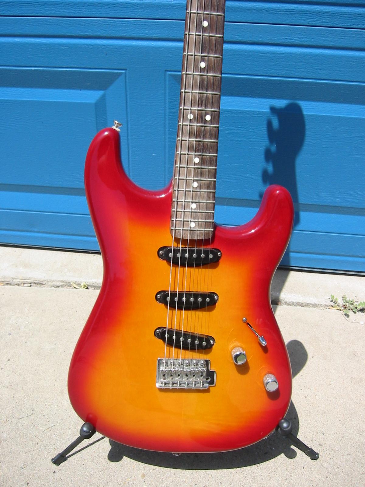

mudshark Posted July 22, 2016 Posted July 22, 2016 Solved the tone control to bridge problem with this FMT Strat....hands down the best Mexican Strat I've played.....Fender Mexico only made these one year and they came in cherry sunburst or tobacco sunburst....paid less than $300 on eBay, and pickups suit me just fine, but then again, I'm not much on pickup swaps.
