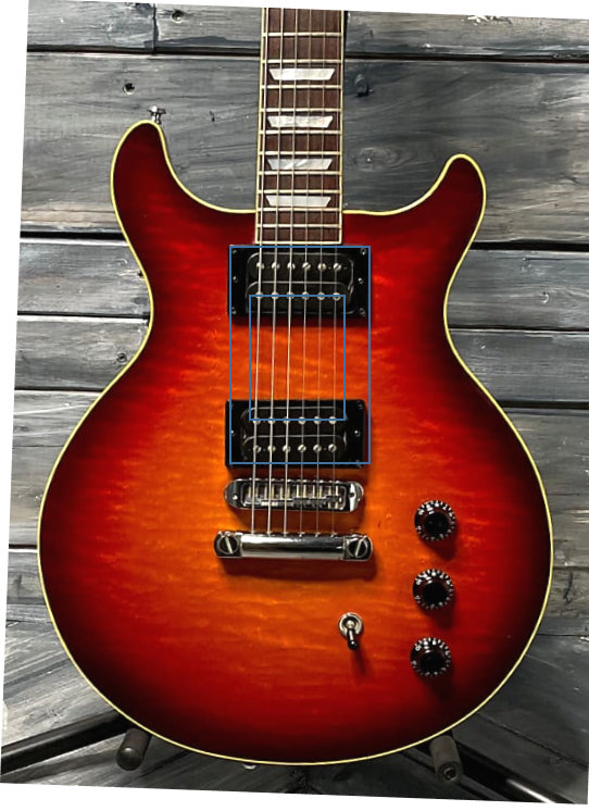

kurtsstuff Posted May 25, 2022 Posted May 25, 2022 I think the pickup is "Canted" and not the bridge?? It doesn't look right to me.. but...too much money anyways.. lol! https://reverb.com/item/55449278-used-hamer-usa-1985-double-cutaway-flat-aaa-top-electric-guitar-with-hamer-case
crunchee Posted May 25, 2022 Posted May 25, 2022 I'm used to seeing Sustain Block bridges on Sunbursts, not Schaller TOMs (which looks to me like the same kind that's used on Heritage guitars, BTW); but I just realized (maybe it's my bad eyesight at fault here) that, if the bridge is slanted for intonation purposes, then it appears to me to be slanted in the wrong direction on this guitar, unless it was strung lefty for some weird reason. That reminds me, since the top's mentioned so prominently in the Reverb listing, I gotta ask: Hamer Sunbursts are usually only topped with veneer, even on a Sunburst made in '85, correct?
Tortious Posted May 25, 2022 Posted May 25, 2022 Sure doesn't look like the 'original pickups'. Or the original bridge. Not sure how they came across that 'rating' for the top, either. I had a rather difficult experience with that seller once.
OUTLAW1969 Posted May 25, 2022 Posted May 25, 2022 Agreed, something appears to be a little bit off with the alignment of the bridge pickup. Unless it is the angle of the photo, you can almost see the misalignment (in one photo in particular), as the strings cross over the pole pieces. If the high E side of the bridge pickup was brought down, and level, it appears that the strings would line up better over both coils.
crunchee Posted May 25, 2022 Posted May 25, 2022 I just realized that the bridge may be slanted in the wrong direction for a right-handed/strung guitar. Please see my amended post above.
topekatj Posted May 25, 2022 Posted May 25, 2022 Could be that they can cant the bridge improperly, or perhaps they can’t cant the bridge properly. It just goes to show they can’t get it canted properly sometimes, can they? It’s uncanny.
Eli Posted May 25, 2022 Posted May 25, 2022 The trapezoids look suspect as well. Instead of pizza day, whiskey day? Or more likely frankenstein day not at the factory.
gorch Posted May 25, 2022 Posted May 25, 2022 Definitely not worth the price without a sustain block, if in any way trustful. The pics look highly polished which suggests of hiding something. Actually, is the stadium logo period correct for that model?
GuitarGuy65 Posted May 25, 2022 Posted May 25, 2022 Something looks off on this one to me. The body shape looks more like a Washburn to me than a typical Hamer/Gibson double cut, and gorch is right about the stadium logo too, never seen one that early on...
kizanski Posted May 25, 2022 Posted May 25, 2022 That's not an '85 serial number, the 3rd inlay is crooked in every photo, and the bridge is installed backward. But 5 grand? Seems reasonable.
BadgerDave Posted May 25, 2022 Posted May 25, 2022 Aftermarket bridge with extended adjustment range plus saddles set at the the rearward limit suggests intonation issues. I suspect the bridge pickup ring was mounted poorly after it left the factory, possibly because the original mounting holes were stripped.
murkat Posted May 25, 2022 Posted May 25, 2022 that's not right. wrong bridge and backwards. Bridge pickup mounting crooked. crooked inlay job with round edges. soft shoulders on headstock. Font is close, but off. binding is suspicious.
kizanski Posted May 25, 2022 Posted May 25, 2022 That's not even a '95 serial number... The guitar is totally fugazee. But at least it's expensive.
bruce919 Posted May 25, 2022 Posted May 25, 2022 It dose look like a Schaller TOM style bridge from that era. Sunburst in general from the mid 80's are seldom seen. Other Hamers I have seen from the mid 80's era with TOM/Stop tails usually have the narrower, Nashville style Schaller bridge. IDK if it the wider TOM bridge but the tail piece looks too close to the bridge.
DaveL Posted May 25, 2022 Posted May 25, 2022 Is it a reworked import? That fretboard doesn’t look USA quality. It’s not turquoise quilt so that would likely rule out Ed Roman.
Drew816 Posted May 25, 2022 Posted May 25, 2022 STADIUM LOGO! When did those even first appear? You guys tell me... And is this a Sunburst?! It has all the "appointments" of a Sunburst but isn't labeled as such. The case looks like brand new, "possible" I guess but really? Me smell a "fake." There's a lot wrong on this bugger that just isn't adding up. Or maybe it's a Re-Top project, but the bound neck too? You guys know these better than I do, but that BRIDGE is an in your face warning sign to me. Nice top though, and yes as mentioned, at least it's insanely priced to compensate! 😉
RobB Posted May 25, 2022 Posted May 25, 2022 On 5/25/2022 at 6:18 AM, bruce919 said: It dose look like a Schaller TOM style bridge from that era. The bridge is an aftermarket Schecter “Cross-Lock” from the ‘80s. I think Stars Guitars made these. Once the intonation is set, the saddles are locked with two Allen screws. Notice how the post-holes are offset? This is so the bridge sits perpendicular to the pickup. I had one of these on my LP Stamdard 80 for 15 years. Not attractive, but a very solid alternative. If you search early photos of Kirk Hammett and his black V, you’ll see he used one, too.
Biz Prof Posted May 25, 2022 Posted May 25, 2022 To my eyes, it appears that both the humbucker/ring and the aftermarket bridge are slanted. The bridge is slanted on purpose, but the pickup...
Biz Prof Posted May 25, 2022 Posted May 25, 2022 Photo angles can be deceiving (Shown below, I angled the original photo by ~2 degrees in an attempt to make it square and then overlaid rectangles at true zero degrees), as the guitar is sitting on stand at some degree of angle opposite the camera. Still, I'm with Murkat. Too much stuff just doesn't line up or look right.
Jim85IROC Posted May 25, 2022 Posted May 25, 2022 14 minutes ago, Biz Prof said: Photo angles can be deceiving (Shown below, I angled the original photo by ~2 degrees in an attempt to make it square and then overlaid rectangles at true zero degrees), as the guitar is sitting on stand at some degree of angle opposite the camera. Still, I'm with Murkat. Too much stuff just doesn't line up or look right. that manipulation definitely helps, but any camera angle distortion aside, the intonation on that bridge alone screams "WRONG SPOT"
soli'd Posted May 25, 2022 Posted May 25, 2022 don't think I've ever seen a bound headstock on an early sunburst. or maybe any sunburst now that I think of it.
kizanski Posted May 25, 2022 Posted May 25, 2022 24 minutes ago, Biz Prof said: Photo angles can be deceiving (Shown below, I angled the original photo by ~2 degrees in an attempt to make it square and then overlaid rectangles at true zero degrees), as the guitar is sitting on stand at some degree of angle opposite the camera. That's true, but when the same object is visibly crooked in several photos shot at different angles (the 3rd inlay) it's just crooked. 1 minute ago, soli'd said: don't think I've ever seen a bound headstock on an early sunburst. or maybe any sunburst now that I think of it. The "Armstrong" headstock Sunbursts were bound, but that's obviously a different animal. That said, I think it's folly to try to compare this to any legitimate model and/or Hamer era because I don't believe it is either a Hamer or legitimate.
Biz Prof Posted May 25, 2022 Posted May 25, 2022 1 minute ago, kizanski said: That's true, but when the same object is visibly crooked in several photos shot at different angles (the 3rd inlay) it's just crooked. Exactly! I probably didn't make my point clearly enough. I tried valiantly (whilst eating leftover fajitas for lunch) to line up the angles of specific parts of what we know is a three-dimensional object and while I got a few things to align, it's still definitely fucked-up looking. The eyeball test always applies.
